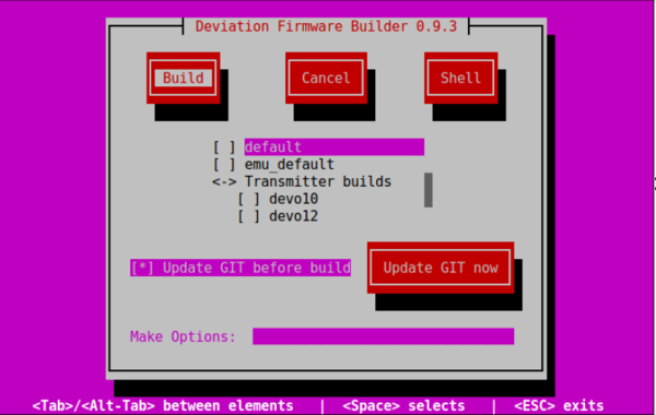

Once you've started the Docker container, it will update to the latest version of the build script, and then will try to checkout deviation if you did not provide a GIT repo. Next a menu will be shown which allows you to choose what you would like to build.
Initially, 'default' and 'emu_default' are selected. This will build all zip files that are normally part of a nightly build.
The 'Shell' command will provide an interactive Linux shell inside the image. This is likely only useful for developers or users familiar with Linux
When you press 'Build' the Deviation images you selected will be built. If you selected emulator images, some extra libraries will be automatically downloaded and built first.
