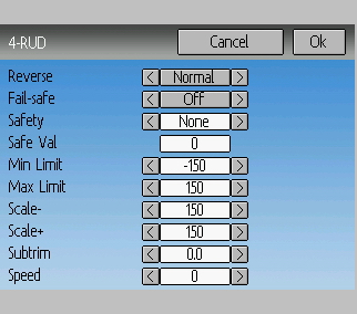

Flight Mode controls the response.
  • Flight Mode 1 = Beginner Settings * Flight Mode 2 = Standard Settings * Flight Mode 3 = Aggressive Settings
Turn up RUD Scale -/+ to 150 if you want faster piros.
