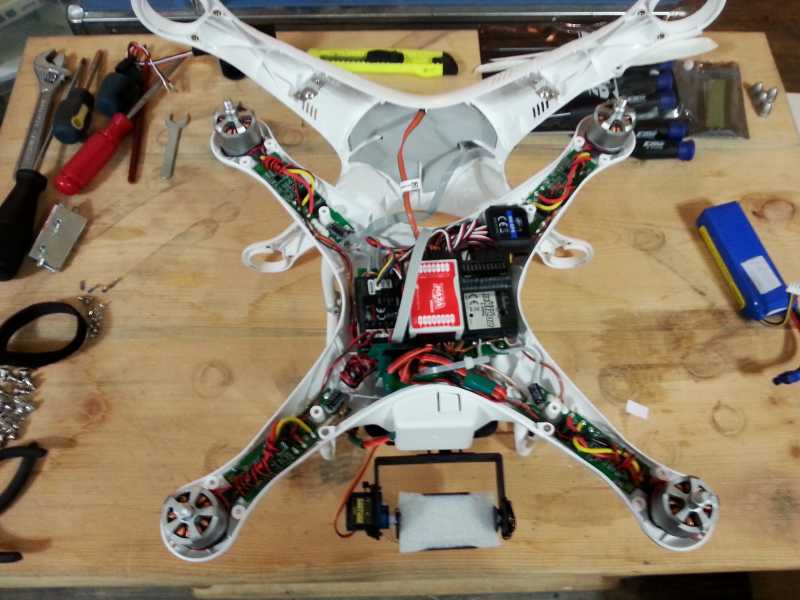

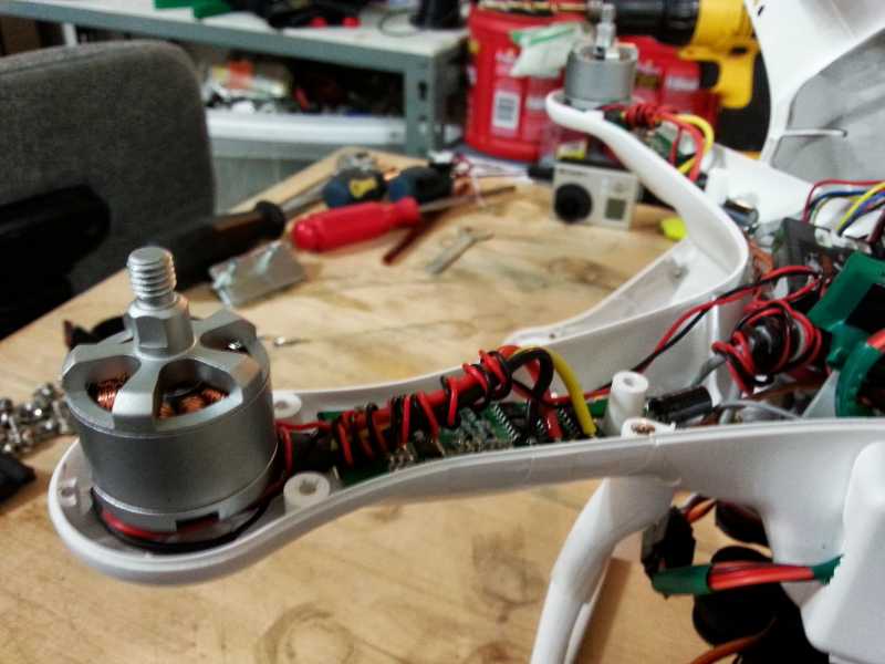

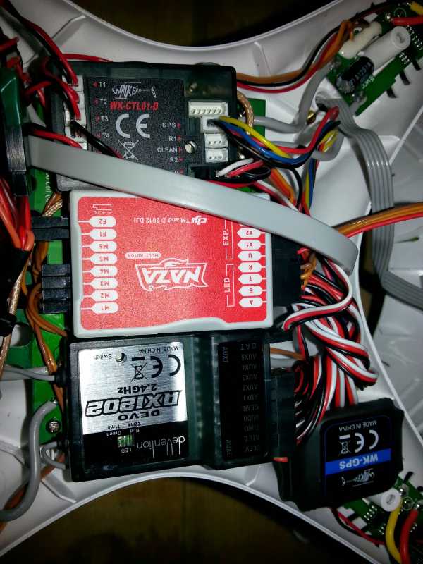

I have modified my DJI Phantom. First I Removed the stock RX module, and replaced it with the RX1202 I got with my Devo 12S. I Then added the WK-CTL01-D telemetry module. The included 4 temp sensors, I wrapped 1 under each motor. Ran the voltage sensor to the main flight pack. Also added the WK-GPS module. All fit nicely under the lid without any trouble.
Wired like this:
RX1202 ↔ NAZA
ELEV ↔ E
AILE ↔ A
THRO ↔ T
RUDD ↔ R
GEAR ↔ U
AUX1 ↔ X1
AUX2 ↔ X2
In the naza assistant, setup the RX1202 as “traditional” type.
Also calibrate!

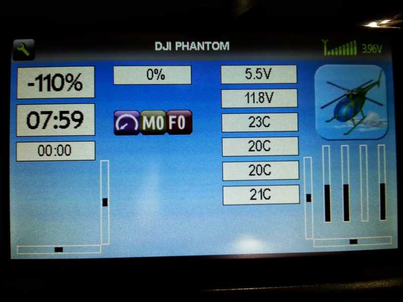

There is an 8 min timer tied to the throttle stick.

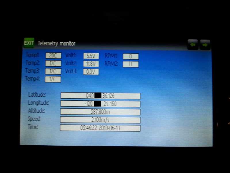

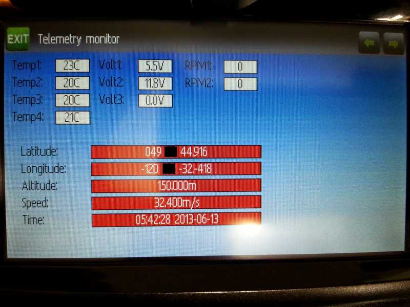

There is also some telemetry alarms set for motor temps and of course main flight LiPo voltage. The numbers may need some tweaking.

Some install Pics:
