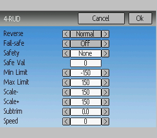

  • TX Power=100mW * Channels=7 * Protocol=DEVO * No Fixed ID * Throttle Hold is active on RUDD D/R switch. * RUD Scale is set to 150 for faster piros. * Stick Mode 2

Turn up RUD Scale -/+ to 150 if you want faster piros.
