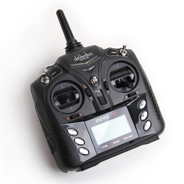

The Devo 7E is the best value for money transmitter that you can buy that DeviationTx supports. It shares the same smaller body as the Devo 6 but instead has a 128×64 pixel LCD screen similar to the Devo 10.
It however only has 128k of flash memory, which is barely sufficient for DeviationTx. It is equipped with only two 2-way switches and a range limited RF module. There are proven modification though to overcome these limitations.

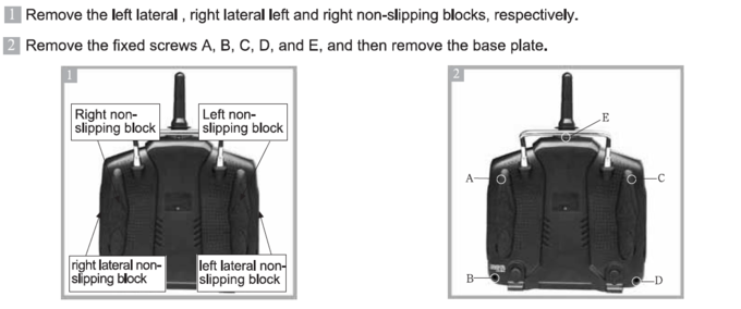

Disassembly
All modifications have to begin with disassembling the transmitter. Here's how to do it.
