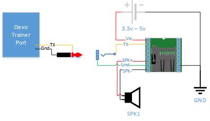

Communication between the MP3 module and Deviation is handled by a 9k6 serial signal which is by default sent to the trainer jack of your deviation transmitter. This means, that voice will not be available when using the trainer port for PPM in- or output.
User Deal57 created the following schematic for wiring a DFplayer to the trainer port:

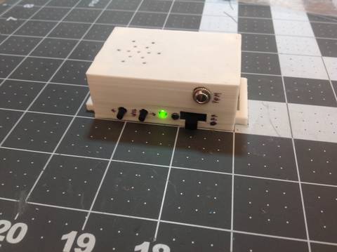

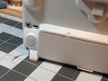

This is an example of an external voice box. Use a 1/8“ (3.5mm) mono cable to connect from the Devo trainer port (labeled DSC) to the voice box. In this case the box includes volume buttons and has cutouts to allow access to the USB port and MicroSD card of the DFPlayer.

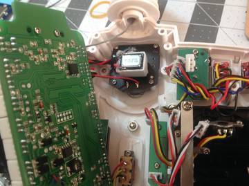

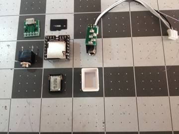

These are the parts used for an internal voice module for the Devo 12e.
internal_voice_components.jpg devo_12e_voice_soundbox_sm.jpgdevo_12e_voice_usb_hp_jacks_sm.jpg

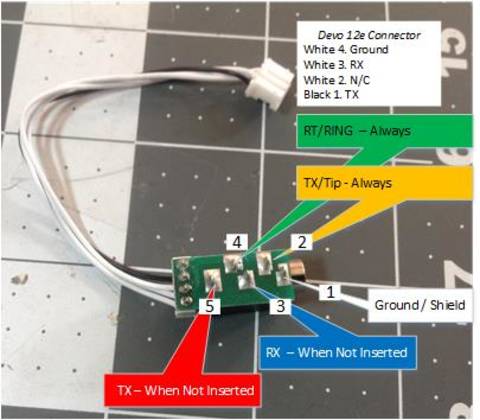

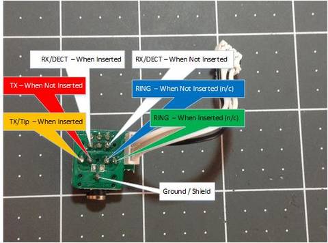

For internal connections, the trainer port connector offers solder points so you can tap directly into the PPM TX line from the processor. For the Devo 7e, 6s, 8s, and 10 (possible others?), use these solder points for the PPM TX and ground lines.
For the Devo 12e, the trainer port connector has these solder points:

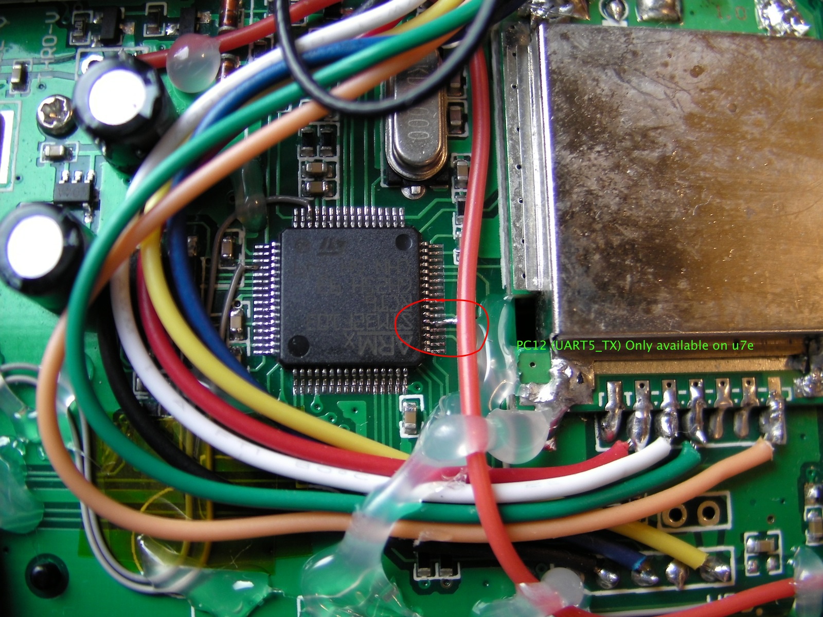

Besides using the trainer port, you can solder directly to a free MCU pin for UART5. In hardware.ini you have to enable the corresponding line to use UART5. Phantom8 provided the following picture:

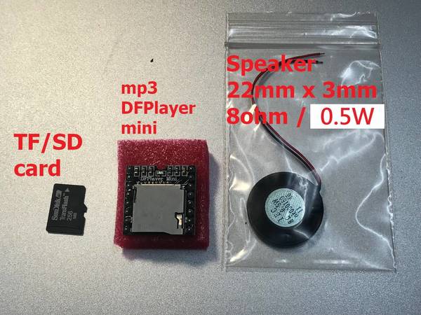

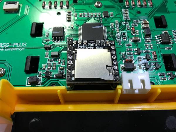

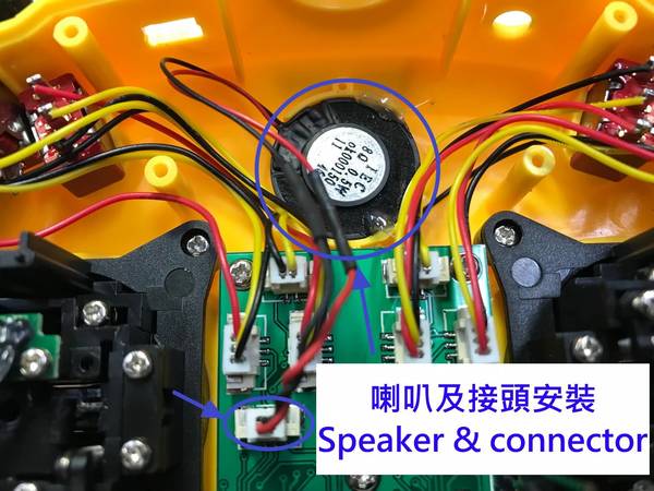

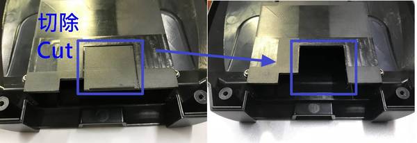

The Jumper T8SG V2 and T8SG V2 plus are already prepared for installation of a DFplayer module. The picture shows the necessary parts to get started. Basically any speaker with 22 mm diameter works fine. First, you need to remove 2 pins on the left and 6 pins on the right side of the DFplayer module as depicted below. Now you can solder module to the T8SG V2 PCB. You will have to unmount the main PCB to solder the pins on the bottom side. The speaker can be mounted beneath the RF module at the top of the case and wired to the adjacent free header with a PH1.25 mm connector or directly wired to pins on the DFplayer module. To fit the battery compartment, you will have to cut along the prepared lines with a sharp knife or a small saw to make room for the DFplayer before reassembling the transmitter. Follow the software instructions below and setup hardware.ini for DFplayer and UART5 usage:
voice=dfplayer
voice-uart5=1

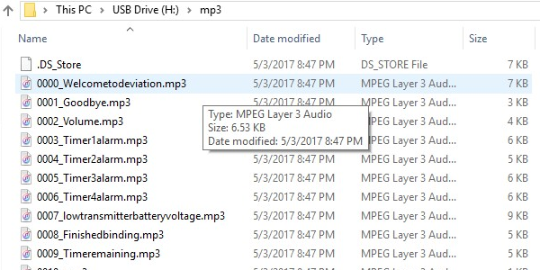

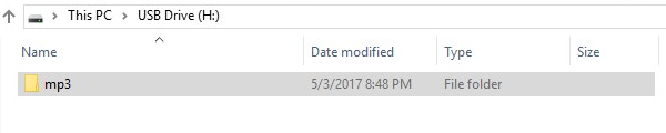

The files for the DFPlayer are saved using MP3 format and are contained in the \MP3 folder on the MicroSD card. The MicroSD must be set up with the \MP3 folder and all the voice alert files must be in that folder. No other files or folders need to be on the card, so the card can be a small as 64MB (the actual disk storage for the largest file set is under 2MB). Each file is named to correspond to DFPlayer MP3 file name convention, which requires a 4-digit number as the first four characters of the filename, and a filetype of MP3 (ex: 0000.MP3 or 0000Welcometodeviation.MP3). MAC users should be aware of special file handling requirements as detailed on the DFRobot page.

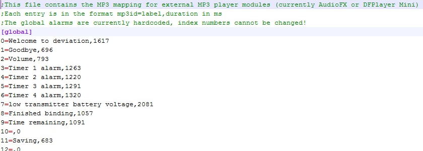

The voice alert files are cataloged in a file called voice.ini that must be copied to the deviation \media (\mymedia on Devo12(S)) folder on the transmitter. The voice.ini file contains lines that correspond to each voice alert file (ex: “0=Welcome to deviation,1617”) that map the MP3 file name and duration for Deviation. Each set of deviation voice alert files must have a voice.ini file to match.
