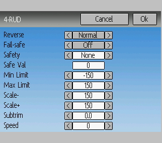

Turn up RUD Scale -/+ to 150 if you want faster piros.
